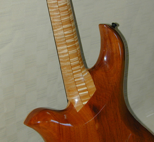

This one is extremely heeless !!! - people ask me all the time how I did the cool curved neck joint. Easy - mortice the neck into the middle PU cavity beofre putting the cap on, then carve away til it feels good !!! The top cap is violin carved quilted maple, tinted deep trans blue, with faux natural quilt binding ala PRS.

Nice Tony!!! What did you use between the maple lams on the neck?

I do quite a lot of heelless electrics. I tend to carve the back on my carved-top electrics as well, subtly. Seems a bit wrong to have a flat surface on the other side of a sexy carve...

Thats mahogany veneer, to match the back/body wood.
Wow Mattia - that finish looks DEEP !!!!
